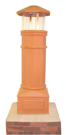

Ah, you need one of my inventions....
http://www.extendaflue.com
I can sell you the castings and and adapter and you can run the pipe up through it.
Great deals now..........

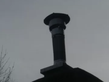

Hey Jason,
I am facing the same issue as you. My chimney is just over 14 ft so I left 3 ft of the SS liner out the top and put the chimney cap on top of that for a total 17-18 ft. length.
My setup just barely met the 10-3-2 rule and since my chimney is exterior and the manual calls for 13ft min I figure it would be a good idea to add some length. so I am left
with a less than pretty install until I come up with a way to cover up the exposed SS liner. Perhaps a piece of galv sheet cut to fit? I like the extendaflue but was put of by the cost.
To late to go back on the roof now so it will wait until spring to finish it off.. I'm open to other ideas as well
Here's a pic of what it looks like with the SS sticking out..

Most definitively looks beautiful, No argument there.. But at $900 for the 12" model I would expect it to sweep my chimney, buck, split and stack my firewood and maybe do some other chores around the house. As for working better, I doubt that as length is length. No matter how attractive it may be the physical length is what it is. I figure I already paid for the stainless steel liner so why not take advantage of extra length if possible.
This is just a suggestion/observation for ya Jason if like me you must limit your cost.
I plan on wrapping the exposed flex liner piece with some ceramic blanket and wrapping that with a piece of stainless or Galv sheet cut to fit.
I don't know how the draft would have been had I cut and terminated it flush to the chimney top but I can say I have good draft at the present 17-18Ft it is now. Even when the insert is cold there's a nice draft up the chimney when I open the door.

Ah, but you didn't ask YOUR price...... Hearth.com membership has many advantages
and without the ss liner.......is cheaper......
let's put it this way. Closeouts are $175-$300.......

Craig,
That's one heck of a discount and certainly makes the extendaflue a much more attractive alternative.. At that price range you are in line with the cheapest I have found elsewhere.. Thanks!!

What I have is the flex liner extending a few feet out the top of the Chimney. The liner is uncut from the stove to the cap. No rigid pieces in the mix here. I left it this way to take temporary advantage of the extended height while trying to figure out a more permanent and visually finished solution. I suppose you could put a rigid section up there coupled to the top plate with a collar but I have been unable to confirm that.
If I go the cheapest route, using a piece of galv sheet cut to fit between the top plate and the cap I may also paint the entire thing either a Terracotta color in line with the extendaflue or maybe just black. I think a paint job is in order since the galv will look like crap after some time exposed to the weather. Even my existing stainless top plate and cap would look better painted due to the lower grade stainless that comes with the liner kits. Cost goes through the roof "so to speak" if you want high quality stainless parts that look good and retain that look when exposed to weather.
This stainless flue extender will set you back $340 from Northline Express!! Craig's discounted extendaflue offering looks much more attractive all things considered. I would love to hear about other solutions folks have come up with??

If I had to choose for my house I would go with Craigs solution. Very attractive appearance and price, and no need to try to piece something together. Jason I believe that Craigs cap will eliminate the need for two of the parts in your kit, the top plate for the clay liner and the rain cap. Maybe Craig will verify this? In that case you would only need the liner and whatever fitting for your stove.They should be able to adjust the price on the liner accordingly if this is the case. IMO, Jim

Hey Jason..
How about this as a possible solution. This would assume running the flex liner flush to the top of the flue tile or brick edge like yours and installing the "Rigid-to-Flex" adapter plate that would allow an easy install of a removable 4 foot section of stainless insulated rigid liner and cap. It would bring my chimney to a respectable 18+ ft. and look nice to boot..
for my installation it would also allow easier cleaning from the top as having the permanent piece of flex sticking up 4 feet makes the chimney to tall for me to clean from the relative safety of the roof, I don't like doing it from a ladder and dealing with cleaning rods and brushes, a recipe for disaster at least for me !!
