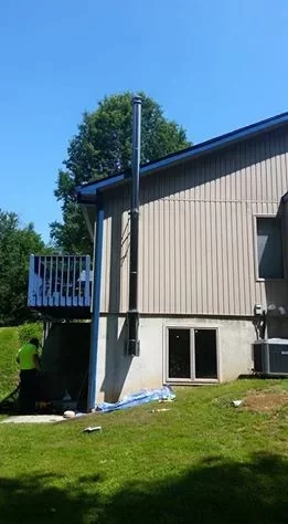

Your proper install will look something like this:
plus much cheaper than a masonary chimney
That would be a very expensive way to do what a metal chimney will do. If you want to disguise the metal chimney build a chase around it, with a minimum of 2" clearances around the pipe.
