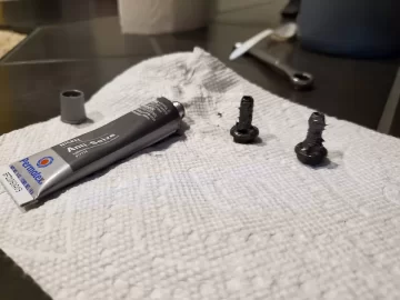

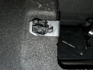

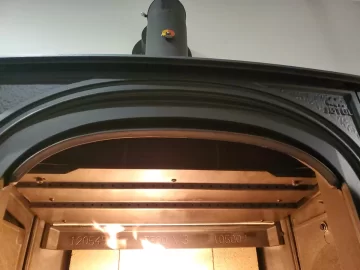

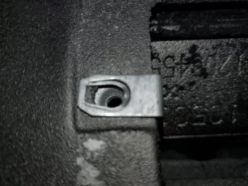

Hey there woodstove fans, I did a little work on my new baby recently. Got her centered on the hearth, pipe positioned, need a few new screws. Pulled the inspection cover tonight:
[Hearth.com] F 500 V3 Oslo CF

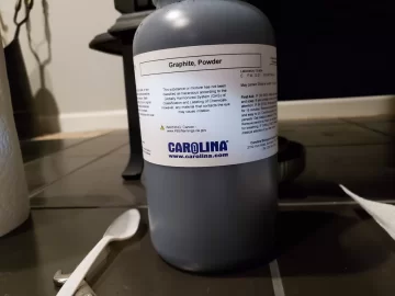

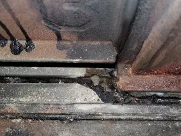

At @begreen 's recommendation, I applied some graphite powder to the primary air slider area.

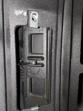

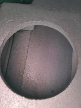

And because I want easy acess to this area once the burning begins:

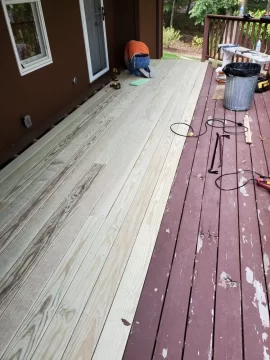

This is what I was working on earlier today, surprised I had any energy to work on the Oslo afterwards, must be fall crunch season [Hearth.com] F 500 V3 Oslo CF

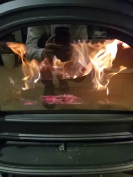

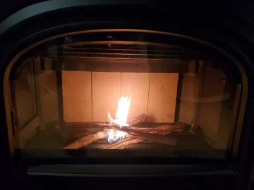

I got the all clear from my town's building inspector a couple of weeks ago! Did the first break-in fire yesterday:
[Hearth.com] F 500 V3 Oslo CF[Hearth.com] F 500 V3 Oslo CF[Hearth.com] F 500 V3 Oslo CF
I preheated my flue by pointing a hair dryer above the baffle (I have to retire my propane torch, no bypass to get around the cat on this stove), and my fire lit right off, fully closed load door immediately. Not bad for a 55°F day! Last pic above shows no smoke roll-out just a few minutes into the burn.
Had to throw a few small splits in to maintain 200°F for one hour:
I burned a second break-in fire today. Had to leave the front load door cracked for a few because we were at 63°F outside. Still no smoke roll-out once going!
Got up to 400°F on the stovetop with a couple of small reloads, and a final few small splits to carry the 400°F for an hour.
Next one will be 500°F, have to wait until temps drop again on Sat. So far, so good! Very impressed with this new combustor, I notice no draft restriction as compared to my Carabassett on the same flue.

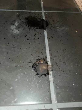

Wow, that is very disheartening. I hope the dealer helps you out with a replacement stove. Will you try another F500 or try something different?
We had the same black bleed from our Castine. It went away after the fire few hot fires.

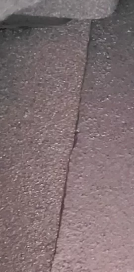

I decided to return the stove to my dealer:
Wow!
I just got the news that Jotul USA can not deliver the blue black Oslo that I ordered until next year. Now I am glad.
Is that a crack in the cast iron I see in your pictures?
That’s a shame about that stove. What are your plans now? What’s next for you?
