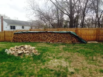

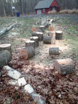

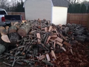

i have 5 cord from march now all mixed. ive been cutting away this past month trying to get more for next year and trying to get set for the year after. unfortunately i only have one cord split and stacked that i just finished last night. still have 3 cord on the ground that needs to be split and about 12 more trees to cut down, buck and split.

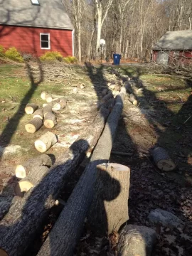

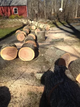

View attachment 147093 View attachment 147094 View attachment 147095 View attachment 147096 View attachment 147097
still need to split all of this
