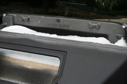

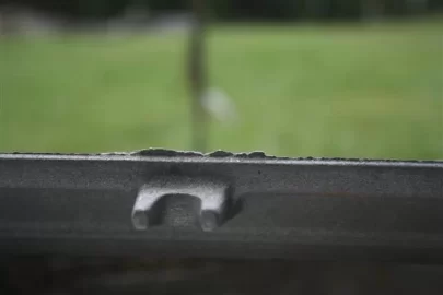

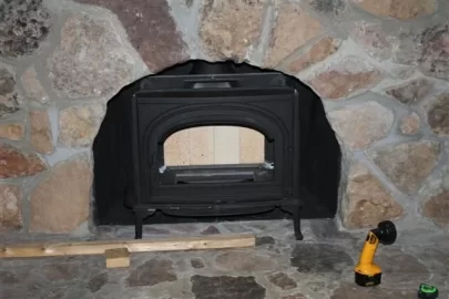

Gasket only. I attached a few photos. One photo shows the casting flash I found that I thought Jotul would have taken care of. That flash sits squarely on the sealing surface for the gasket. The other photos show the stove with the top removed. In the one on the hearth, the top can be reinstalled without moving the stove.

I took the screws out like the manual says, makes cleanup a breeze after sweeping the chimney. There's no good reason to keep them in.
Because it would seem like I can undo the front and slide the top plate out, I kind of figure that's the both of best worlds. Thanks for everyone's answers.

At first I didn't recognize your stove as a F500 without doors looks naked, I sure thought the whole top was bolted on with 4 bolts one in each corner have never removed it but have felt around thought I felt them.
