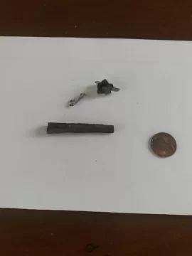

This was my first winter with my new Jotul Oslo. It was great until a few months in I noticed pieces of the cement from the joints falling out. Now smoke pours out of the joints in those spots so much that it is unusable. The dealer is trying to come up with every excuse to blame me for the problem. Now they want me to pay for a chimney sweep to come out and inspect. Would I have any luck going directly to Jotul?
Normally if cement came out of a joint, the opposite would happen. Air would get sucked into the firebox causing a too lively fire. That may be what the dealer is thinking. Can you show some pictures of the places of concern and where the smoke is coming out?
Note that Jotul puts a generous amount of cement at the joints so there is a lot of ooze. Even if a chunk broke off the cement should still be intact in the stove joints. A plugged cat could be the issue or the flue.
Thanks for your reply. Attached is a picture of some of the chunks that fell off and I tried to add a video of what happens when I light the stove, but it says it is too large for your server. I think it’s quite possible the cat is plugged and I can understand smoke coming out when the door is open, but should smoke ever come out of the seams?
