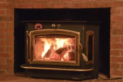

Are you referring to the surround that closes the insert into the fireplace? If you are, I left mine off for that very reason. That and I liked the way it looked better than with it. I'm convinced that I get more heat without it. I'm thinking of putting a small fan on the hearth blowing into the area behind the stove to try to get even more heat out. I think a block off plate is even more important for retaining heat. [Hearth.com] Faceplate with insert
