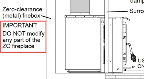

My biggest question is whether I can dismantle portions of my z/c to accommodate the insert? That's where the sales guy at the local stove shop is going with his suggested method.
Wait, you just said you want to get rid of the fireplace. Which is it? You can not dismantle anything but taking off the doors off the ZC.
From the ZC manual:
13. DO NOT use a fireplace insert or any other products not specified herein by the manufac- turer for use with this fireplace. All gas log sets must be operated with the damper clamped open. "Vent-Free" logsets may not be used in manufactured home installations.
This is from the Enviro manual:
[Hearth.com] Fact checking the sales guy
I would plan on a full tear out and then decide whether an EPA ZC or freestanding stove is desired.

After they suggested that you shouldn't let them anywhere near your house. That zc unit shouldn't have an insert put in it at all but to recommend modifying it is just absurdly irresponsible.
