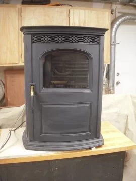

I am in the market to buy a pellet stove and found a Harman Accentra stove for sale locally. It is used and I don't have much info about it yet except that it is "in good working order and cosmetically in very good shape" according to the seller. I have attached a photo of the stove.
I am looking to get some advice on a fair price for the stove. Also, is this a good quality stove? And, what sorts of things should I be looking out for when I go inspect the stove?

what's the asking price?
Get the cash and go fire it up and let it run till the fan runs. If it does, load it and go and don't look back because the owner may try and run you down to get it back. Looks like it even has some venting!
How old is the stove? If it works $1000 is a good price you could offer a 100 less but if it works I would buy that stove. Harmans are the top of the line imo.
You could put the stove on test mode and listen to the fans. If you want to run it bring some pellets with you and fire it up and listen to the auger for any strange noise.
That seems like a pretty good price. If all is in working order, I wouldn't fart around too much or it'll likely get snapped up.
Tons of help on here if you need it.
AGREE. That stove would of been history around here so don't think about it too long.

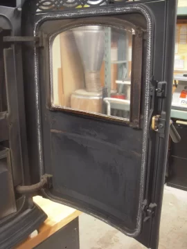

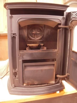

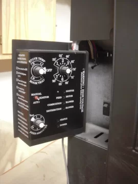

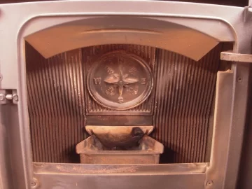

Ok, here are some photos of the stove and extras after I got everything out of the truck and into the garage. It appears to be pretty dirty. I will read through the link that was posted above before I start taking anything apart. But, I am assuming a shop vac is a good start point for big stuff that is in the stove? Also, is there a "best" method for cleaning the cast iron? It appears to have some drywall powder on it, and some dirt and grime.

Looks like you have a winner, take the 2 back side plates off and focus on that area while you have it in an easy position to clean:cool:
