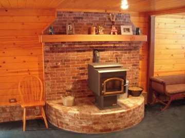

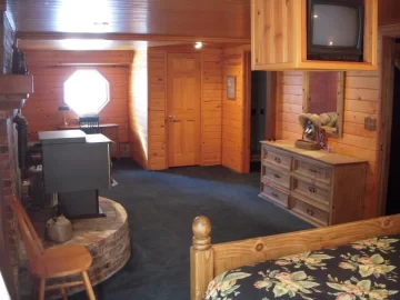

Here are some photos of what I am dealing with. The pellet stove in the photo is no longer there. Soon, the Accentra will sit there!
[Hearth.com] Fair Price for Harman Accentra Pellet Stove? [Hearth.com] Fair Price for Harman Accentra Pellet Stove?
12" seems a bit low, but if that's what the manual states, you'll be OK. However, you'll need to be absolutely positive there are no combustibles in the vicinity of the vent, particularly on the ground (mulch, etc.) Also, if you get a lot of snow there, you do not want the vent/intake to get buried.
This setup eliminates the need for a clean out T and will make vent cleaning a piece of cake.
The proximity of the OAK intake to the vent is fine. You'll want about 2' of vent extending beyond the outside face of the thimble.
ETA- You'll also want to make sure you don't end up with a joint in the thimble. I'm not sure if that's code or not, but I wouldn't be comfortable with it in my house.
Nice, looks cozy. It'll look better when the new stove is installed ;)

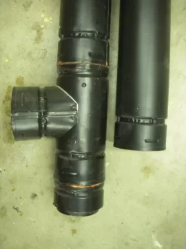

Did you determine the manufacturer of your vent that came with the stove? You'll need a termination cap for a horizontal install if it didn't come with one. Also, make sure you have an appliance adapter to go between the stoves exhaust and the beginning of your venting. You probably already have one. It'll be around 4" long.
Mulch out. Rock in. Easy peasy.
Tree out.... not so easy peasy. I will take a look at it when I am up there. I'm sure I can work around that.

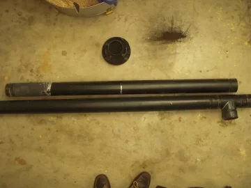

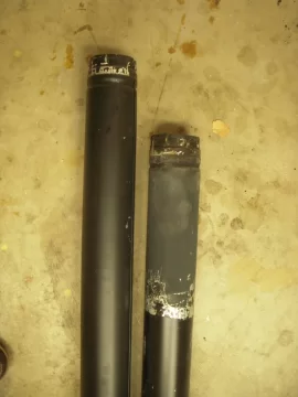

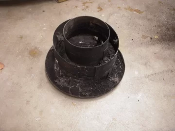

Venting: I don't see an appliance adapter. I will need one of those. I also don't see a termination cap that would work. The one that came with the used venting appears to be for a vertical install, maybe? There is something on the wall outside right now that terminates where the existing vent is (was). Maybe I can use it. I will get better pictures. As far as the brand of pipe.....I looked and couldn't find any manufacturer's witness marks indicating anything to me. Can someone tell from the photos?
Thanks for the 66 answers/questions so far!
Bill
[Hearth.com] Fair Price for Harman Accentra Pellet Stove? [Hearth.com] Fair Price for Harman Accentra Pellet Stove? [Hearth.com] Fair Price for Harman Accentra Pellet Stove? [Hearth.com] Fair Price for Harman Accentra Pellet Stove?
I suppose there's a good chance that's Duravent, as it's fairly popular and commonly found in BB stores. Looks identical to a section of Duravent I have here, but then again, I'm just going by your pic, and PV generally looks quite similar.
Can you take a section of yours to HD or Lowes, or whoever sells it in your area? If it looks the same and locks together positively, without any slop or funkiness, it's probably Duravent.
You could always just replace it altogether and get the appliance adapter and term cap and have peace of mind.

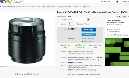

I think I need a "special" adapter for the Harman.....is that right? The manual calls for this due to Harman's irregular size. Maybe I will order and see if it snaps together with what I have already. If it does fit the pipe I have, can I cut the pipe to length at the termination point? or does the the pipe have to connect to some type of termination cap with a factory end?

I wouldn't mess around cutting, or otherwise trying to rig anything up. You do not want fire or smoke in your house.
I wouldn't order anything until you're sure of the brand of your pipe. Also, I noticed what I though was red RTV in the seams of what you have. If that's in there, and you need to separate the sections, it could be a pain. You'll need a couple strap wrenches and having a helper would be nice.
Well, if I can't cut the pipe, then I don't think I can use it with this install idea. It is just too long. I will just buy the adapter and a 2' piece of pipe to attach to it and go straight out with it (ideally). How do I terminate outside to protect from weather, birds, etc?

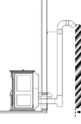

Do you know the approx dimension of the brick, inside to out? I know the rear clearance of the stove is 2.25", but I'm not familiar with the mechanics on the back. If you needed to access anything back there, you'll want room to work and not have to pull the stove out every time. Perhaps you could start a thread, or do a search, for what rear clearances Accentra owners typically use and how much room is an "adequate" amount to have back there.
I looked more closely at your vent pix and can see those are really long sections. Without knowing your intended rear clearance, and how thick that brick wall is, it's tough to suggest any venting configurations. I'm thinking an appliance adapter, 36" section of pipe and a termination cap, would put you in good shape. If you opt to go with new stuff, I wouldn't hesitate to use Duravent, or whatever your BB store sells, reason being you'll have minimal joints and won't have to worry about notoriously leaky elbows. You should be able to get those 3 pieces for around $100. Also, gab some high temp silicone, high temp vent tape, and a couple stainless 1" self tapping sheet metal screws (for securing the adapter to the stove).
Seems like you're settling in on your venting choice. Looking forward to future updates.
Yeah, I think I am really close. The last pieces of the puzzle I won't be able to put together for a couple weeks when I can get to the home. I will take off the plywood exterior siding and get a good look into the wall and see what surprises might be there. I'll take pictures and then get back with a post for final options.
Good idea on the maintenance clearances. I just cleaned it completely so I know what I need to get to. I think I can figure out a good distance and then work the horizontal pipe section length from there.
Total wall thickness is probably about 10 inches (3.5" brick, 2x6 stud, 3/4" siding).

Appliance adapter may still be attached to the back of the Accentra. For our termination cap, we have a "turbo" cap which is conical in shape and has an interior screen that keeps out most critters. You may want to think about a solid cap for when you are not using the stove - especially if your away for periods of time in cold weather. Amazing what people have found that had crawled in the venting!
