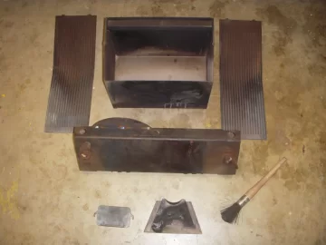

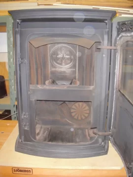

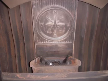

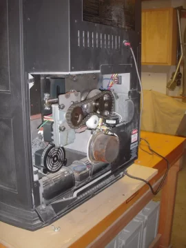

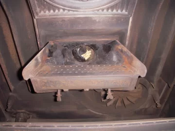

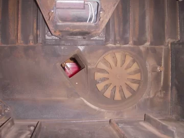

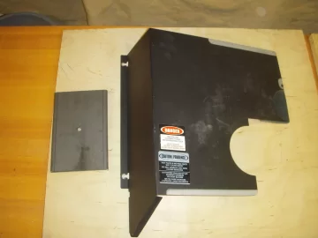

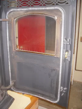

Ok, I just finished cleaning for the first time. Here are some pictures of what I took apart and how it looks after the initial cleaning. Is this what it should look like when it is clean? Did I forget anything?
Thanks!
Bill
[Hearth.com] Fair Price for Harman Accentra Pellet Stove? [Hearth.com] Fair Price for Harman Accentra Pellet Stove? [Hearth.com] Fair Price for Harman Accentra Pellet Stove? [Hearth.com] Fair Price for Harman Accentra Pellet Stove? [Hearth.com] Fair Price for Harman Accentra Pellet Stove? [Hearth.com] Fair Price for Harman Accentra Pellet Stove? [Hearth.com] Fair Price for Harman Accentra Pellet Stove? [Hearth.com] Fair Price for Harman Accentra Pellet Stove? [Hearth.com] Fair Price for Harman Accentra Pellet Stove? [Hearth.com] Fair Price for Harman Accentra Pellet Stove?
Make sure you get the fines box cover on snug. Looks good except its not lit.

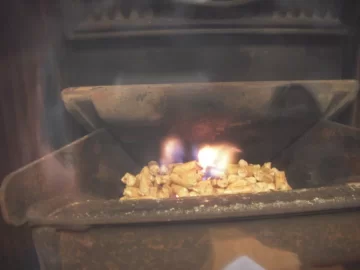

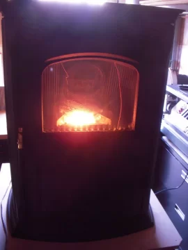

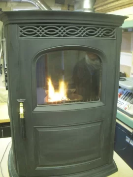

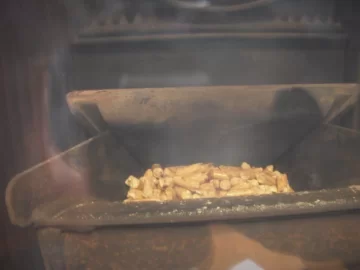

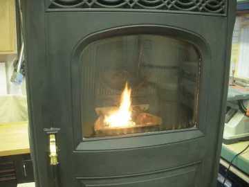

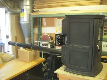

Well, nobody was here to see it, but I captured the moment with photography. I just had a test fire in the stove. As you can see, I stuffed a piece of pipe on the exhaust and pointed it out the door of the garage. The self ignitor worked perfectly (took about 5 minutes to start a fire), the feed motor worked fine, and the combustion blower was working great. I let it run for a few minutes, and then turned it to "off". I didn't leave it on long enough for the distribution blower to turn on, I guess. I didn't realize this until after it was shutting down. Does this blower turn on by itself after the stove heats up a bit?
Everything shut down after about 45 minutes. So far so good!
I do have some questions though.....I will make a short list and post them in a little bit.

Nice! :)
I like the straight pipe
Nice! :)
Yeah, I'm sure the inspector would love the pipe being supported by a cardboard box!

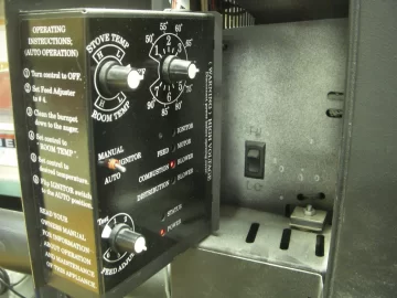

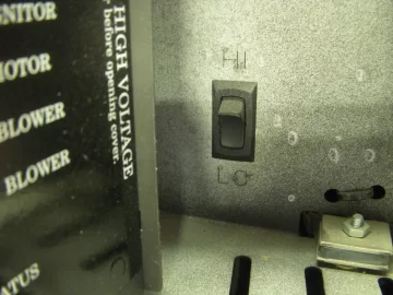

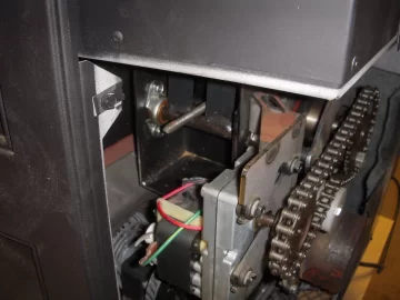

1. There is a small toggle switch behind the control door that toggles between "hi" and "low". I can't seem to find any mention of this in the manual I have. What does it do? (Pictures 1 and 2)

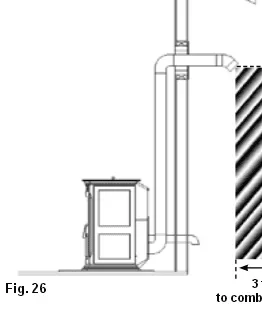

3. The final location of the stove will be on a hearth that is already constructed with a wall thimble that is already in place that fits a 3" pipe. The installation will be basically like the one in Picture 4, except the vertical run will not be near that long. The installation looks to be straight forward, but I am unclear as to how I get a piece of pipe that is of the exact length to fit between the two 90 degree joints. Is there a telescopic pipe section that fits here? Best place to purchase pipe and fittings?

I THINK the switch is a hi/low setting for the fan. You'll still have control of the speeds of each mode with the knob.

You can get an adjustable section of pipe. I think most venting companies make them.

Yes, I downloaded the current manual. It is VERY helpful. In fact, that is where this picture came from for the install. It should be very straight forward since the hearth is present, the wall thimble is in place, electricity is there, etc.
Maybe I'm not looking in the right place, but I can't seem to find a telescoping 3" pipe section that will between my two elbows (maybe someone could point me to a good company that would sell such an item.) Next, how in the heck does one sweep the pipe assembly once it is all fitted together and then sealed with silicone? I'm thinking now would be the best time to design an easily cleanable system. Maybe I am over thinking it all.

Are you planning to use any of the venting that came with the stove? If so, you need to stay with that brand.
Does your manual give specs on vent length, EVL, etc?
Also, keeping the venting clean is quite easy If you have a set of rods, a vent brush and a cordless drill. You'll probably want to install a clean out T at the bottom of your vertical rise.

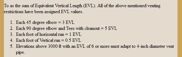

I don't think the venting that came with the stove can be used. It is all too long (unless it can be cut to size). The manual says "3" pipe up to 15' then increase to 4" pipe" "No horizontal runs longer than 48" The manual is silent on a high altitude conversion of these numbers. I just now learned what EVL stands for (as clipped below). Seems like I might need to go to 4" pipe.
Bill
This is not from the Accentra manual. It is clipped from another website.

Here are a couple sources for Duravent brand adjustable pipe sections. One is for a 3" inch, and the other is 4". Duravent is quite common, but is also generally known for being leaky. It can be sealed with silicone, but a leak can be a pain to track down sometimes.

Is the EVL info you clipped for a Harman stove? How far is it from your stove exhaust to your thimble hole?

If you are at higher elevations, atmospheric pressure is increased and will restrict exhaust more. If you are over 3,000 elevation, they recommend you keep EVL (Equivalent Vertical Length) to 7 if using 3" pipe (over 7, 4" pipe recommended). This is calculated by 90 elbows/cleanouts = 5', 45 elbows = 3, horizontal 1' = 1', vertical 1' = .5' You mentioned 2-90s that equals 10 EVL already.
Just saw you got it figured out....
