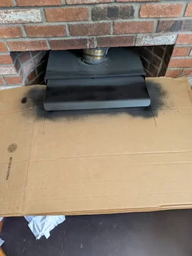

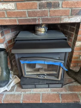

Thanks to my dog every couple years I need to repaint the top of my stove. We do our best to keep him away but he still manages to fling drool on it from across the room!
Wire brush on the drill, hand steel wool, some acetone to clean it, and two fresh coats here. I use SBI metallic black to match the finish. It's a little extra due to the shipping from Canada but that's fine. I'm always happy with how it turns out. I don't bother repainting the ash lip as often as it just gets destroyed again a few weeks into the season.

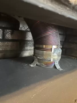

Looks like the appliance connector should be a 15 or 30º elbow connector instead of a straight.

Yeah I agree it should be angled. This was installed back when I was a total greenhorn and didn't know any better. It's been working fine and I've had it inspected by my sweep who I trust and its nice and tight. So I figure I'll replace it with a more appropriate angled connector when it's time.

I have the same issue. In hindsight, an angled adapter would have been a much smoother fit. But mines been inspected, it works fine, so I’ll replace when I have to. Don’t wanna rip everything apart if it’s not necessary.
