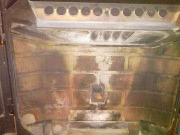

Still cleaning the firebox and firebrick panel. Got more emery cloth at Home Depot and picked up some 0.7" wide Rust-Oleum orange masking tape from AutoZone auto parts store. It seems to be the exact width of the mortar joint so it should work. The firebrick is still dirty so I have to clean it a few more times with Acetone or Firebrick cleaner which I also purchased from the local hearth shop.
