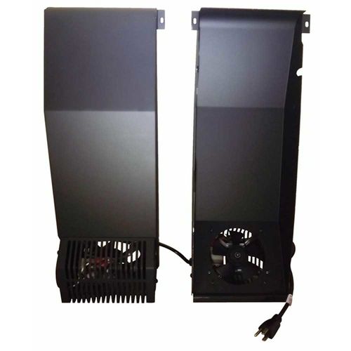

I’m actually on here trying to do research on adding a fan kit to my BK Princess. The stove is too small for the house (3600sq/ft), but isn’t our sole heat source. Helps a lot in taking stress off our heat pump, but I’m trying to get better air circulation.
Can a fan kit be added? Anyone done this? Worth it?
When I ordered my Princess the fan was sold as a separate accessory. It just screws on the back of the stove. I’m sure you could order it from a BK dealer.
Edit: looks like the fan kit is available online for around $300
Reactions: EvertonPete
This is the one I see for sale online.
And the literature from BK
I know the Princess has been changed over the years, so probably best to check with someone from BK before you order one.
That kit is for the princess PE1006. I know mine is a PE32 (2022 model). Not sure if the fan kit is the same.
I have a PE32 and can confirm that part Z1714 is the correct part. I actually bought mine from that website as well.
Thank you!! My stove is also a PE32, installed 2021.
@BKVP you wouldn’t happen to know if the above fan kit would fit a PE32?
IF it is a Z1714, it should fit a PE32.
NOTE: This seller is not a dealer for our products and we have no knowledge of who they are.

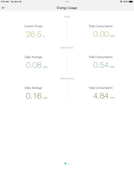

I use a smart plug so I can turn it on or off via internet. But mainly I use it by setting a timer to turn it off at a given time. It works well when I leave for work in the morning. On the way out the door in say, Alexa turn off the fan at noon or something like that. The plug I have monitors the power it uses and also the duration in hours the fan has ran. Naturally the info isn’t real useful but rather a feature.
