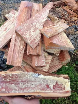

So is this the stuff you guys call fatwood? I was near the bottom of a very large tree and there was lots of this type of wood. I wasn't sure if I wanted it in the stove, like a whole lot of it, so I tried to split off the really visible stuff and save it. The rain does not wash it off and it is pretty solid.
So am I supposed to now chop this up into chop stick like slivers. Will it make a mess out of my miter saw?

Take a hatchet and split it down to 1" slivers, But I wouldn't worry about it. The BK only gets lit once a year, right?
That's pretty cool. I've never seen anything like that but I bet your catalytic stove will really like burning that solidified fir sap.

Actually you want to be quite reserved with that type of stuff till at least getting the cat up to operating temps. No issues using a small amount as a fire starter, but a pile of that stuff in a cold stove could actually poison a cat.

Interesting. As a hybird user who hopes to burn some pine this winter this is helpful info for me. So it basically works like this:
1. A small amount of sappy wood to start is fine
2. Sappy wood once the cat is up to temp is fine (maybe even quite good?)
3. A substantial amount of sappy wood in a cold stove can damage the cat (I assume because there is so much smoke).
Of course, this all assumes the wood is properly seasoned.
Is that right?
Sounds like an accurate take.
Not sure how much sappy wood I would add even to an established fire, though. Too much of a good thing can be hard to control. That sap burns like kerosene.

stop splitting it, keep it in the round, and use it for starting fires when you need it....
or have your toddler cover it in dirt, pine needles and bugs while trying to build a tower. then try and clean off your toddler and forget about lighting your fire.... not that its ever happened....

Baton a hatchet through it making 1" splits like begreen said. It will quickly gum up a saw blade. Makes excellent fire starters. Use the same way you would the super cedars. I reserve fatwood any time I find some for this purpose. Would never think of loading a whole stove full of it.
I even collect the knots that fall out of pine boards in my wood shop when I'm doing a project.

These rounds were over 40" across, I couldn't even get them into the truck without cutting them into sixths.
I'll split them down to thumb size and break up to something shorter than 8". The bk burns for a long time but we have a long shoulder season where I might only need a fire every other day. Plenty of relights.
I do have lots of splits in the stacks that are sap heavy. Hope it doesn't bugger up the cat.
