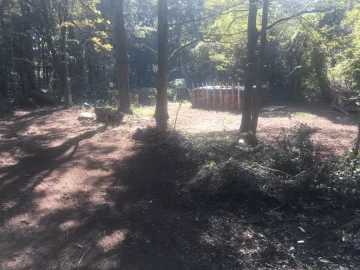

Yep. Covered top only.
[Hearth.com] Federal Airtight FA224 Smoking/Chugging during hot burns
That looks densely packed. What dries wood out quickly is wind blowing through the stacks. Sun helps too. The stacks loaded there might dry out more quickly if they were no more than 2 rows deep and oriented so that the prevailing winds can blow through the stacks. That said, maple is going to want more time, especially in a humid environment.

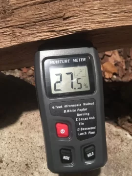

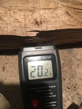

Ok so I retested some new wood. I pushed the living s*** out of the meter into the wood and what do you know.... some more reasonable readings. Though I was gunna break the darn meter. Here's what I believe to a little more accurate.
Maple.....
Oak...
  • [Hearth.com] Federal Airtight FA224 Smoking/Chugging during hot burns
That looks better.
