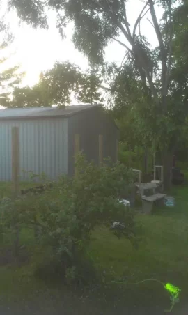

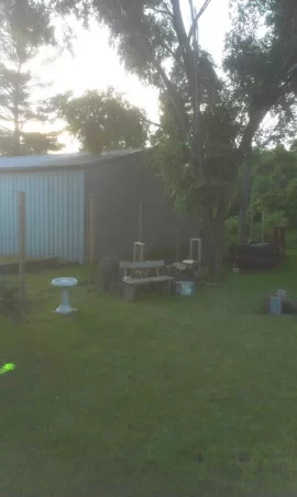

Thanks for all the advice guys I went ahead and purchased 4*4 treated timbers. It's a lot more but very sturdy.
Pete
  • [Hearth.com] Fence post ?

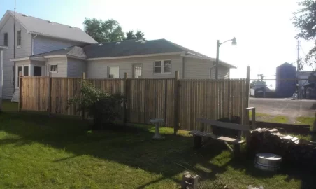

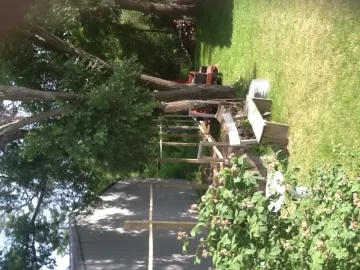

This is the progress so far as well as a slat to show you what I am doing.
Pete

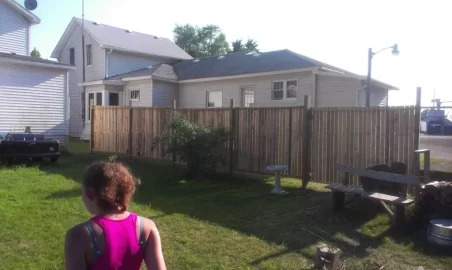

I have another thread I started a while ago sorry bought that I just realized it last night. Here are some more shots for ya with my helper too!
Pete
