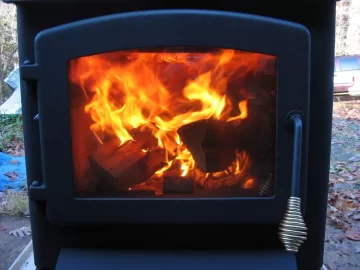

I finally stopped procrastinating and bought a new F55. I'm pretty excited to get it put in place. I'm planning on doing the break in burns outside, is there any problem doing that?

Not a bit. If you have a couple of pieces of stove pipe you can put on for a temporary chimney in the yard, that'll help.
I've never burned the stove off outside. Each time I've had fresh paint, I've been lucky that the temps were warm enough that I just opened up windows and let her rip.
Enjoy!
Reactions: 7acres
One thing to keep in mind if you do your break in burns outside before installing your stove. You have to do several small fires in the stove and let it cool down before you can start doing normal hot fires in it or you risk damage to the stove. Those first few small fires don't really do much for off gassing in my experience. It's not until you start burning some hot fires that you get stronger smells. And even then you will continue getting smells each time you burn a slightly hotter fire in the stove. I don't think it's worth the hassle of setting the stove up outdoors and doing a half dozen fires in it just to deal with the smell of a new stove. At this time of years you can just burn it in the house with the windows slightly open to take care of the off gassing.
Reactions: Mackj
I did my break-in fires inside fully installed with all the doors open in some nice cool weather. Hand towel in hand for fanning the smoke detectors that got triggered.
Congratulations on a purchasing great wood stove!
Did mine outside on one of my five stoves (Jotul Firelight). Used 12 feet of pipe, and it was marginal for draft. Never did reach some of the prescribed stovetop temps, probably due to it being cold out on the days I was doing the successive fires. I just judged what the stovetop should be, based on the size of the fire in the box, since I had experience with that model.
I think it's worth doing, to keep some of the initial / primary stink out of the house, but still expect to redo with proper / known temps, when you move it indoors.

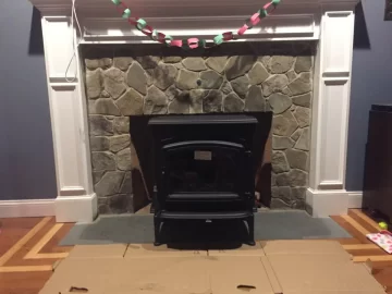

Still need to move it a few inches into place. Anyone see a problem with this install? I know I need to get a heat shield for the mantle
