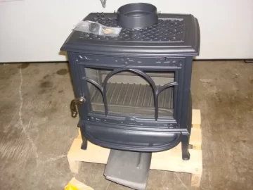

Can't wait to get it fired up! Got my Sellkirk class "A" stainless today also, two 4ft sections that I am going to use inside. I think the polished stainless steel looks great inside but it's expensive! I am disappointed though, both pipes are all marked up and they have creases in them here and there. I know this stuff is for outside but I wish I could find some better quality pipe for inside. Any ideas? Hope you like it!

Cute stove. I came close to buying one off of Craigslist, but it was a bit of a drive for me.

Congrats on your new Jotul F100 baby! Post photos as the install process progresses.
There is nothing like a new stove!
