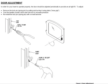

Well Ed, I've got bad news. I did the door inspection last night and everything looked great until I got to looking by the handle where you close the door. I could see fire in the box through the rope gasket.
What should I do now? Should I send an email or call SBI? It doesn't look real bad, but you can see glow in the box.

My issue was with the hinge side of the door and I couldnt adjust the handle to draw it in. Yours maybe fixable. Open the door, under the locking mechanism on the door you will see a roll pin, this pin stops the door handle from spinning around and around, pull that pin out, Now you can adjust your handle by turning the handle to the right or left, when your done latch the door shut to check your adjustment, your handle should not be super eazy to latch shut and it shouldnt take alot of effort to latch either. Once you think you have your handle set they way you want put the pin back in and your all set, you may do a dollar bill test in that area to see if it helped before you light your fire. Side note, you will want to get some anti sieze paste from the hardware store and put it on the threads of your handle that turn inside the casting of the door, this helps keep evrything moving smoothly. This should solve your issue becuase of the location of your gap. Good luck let us know how you do.

SBI emailed me back already, here is what they sent. See pic below. I will try this first -

As Ed and Datfatkidd mentioned, this is a pretty easy adjustment on the Osburn. Just a side note - on the bay models (1800, 2200) the spiral end has to come off the latch handle, to clear the side glass - otherwise pretty easy.

Hey all, is that spring pin pretty hard to remove? I tried tonight after the stove cooled down a bit and I could not get that thing to come out. My pliers kept slipping as I pulled and twisted. I pulled pretty hard too!
Is there a trick to this? Looks fairly easy, but I guess nothing is ever very easy.

Yes, it does not come out easy. I grab mine from the end (pliers pointed toward the door) with a pair of channel lock pliers and wiggle it as I am pulling on it.
It does not come out easily.

FyreBug and SBI can advise on next steps - fwiw though, just sayin' that removing the 2 screws to take a cover plate off he air control on my unit last weekend required a med ratchet and a bit of persuasion (stove is put together like a tank) so it might take some elbow grease to pull the pin...? perhaps SBI would be kind enough to expedite / send you a spare, just in case (that would make me feel better if it was my unit).
edit - spare pin, that is ;lol
Just be super careful and dont break it off in the door you will be screwed. I had to get one for my new door and its a 5/32 X 1/2 long roll pin, $0.30 at the hardware store.

Hey guys, thanks for all your input. You're right that pin is tight... I've broken it myself in the past ;em I just talked to the Director of Tech Support and it's on the list of things to improve as well as looking into the gasket fit. We're not perfect but we try.
Etiger... we're gonna make the pin part of the BOM for replacement door. Thanks for the heads up.
PM me if you have any issues and we'll help you through it.

I guess I jumped the gun last night thinking the problem was resolved. The door closes pretty tight and I'm afraid that turning the handle counter clockwise one more time might make it really hard to close.
I can still see glow from the fire right by where the latch is in the door and about an inch above that. It almost looks like the rope gasket is smashed down there.
I guess I'm going to have to email SBI back with info.
