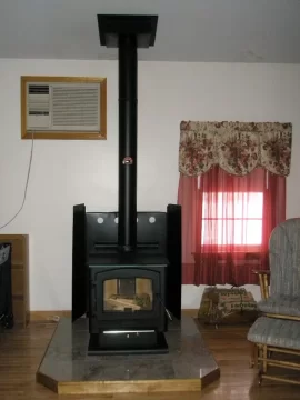

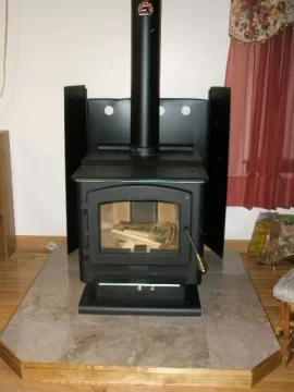

ya heres my englander 30 ..just finished yesterday..got the marble tile a buck a piece...
Sweet deal. I need to get a stack temp guage too. I like the idea of that. Thanks ;-) Im a bargain hunter too. 1$ a Sq foot is gOoooooooD
Do you have the clearances correct for the that stove? That looks to be very CLOSE to the wall for an old smoke dragon.
I dont have 3' all around. I have 2.5' on the side wall and 21" on the back wall. I gets pretty warm. but I can put my hand on it after many hours of burning with out a problem or burns. I keep a pretty small fire going. I dont open the air vents up all the way once it gets cooking in there.
