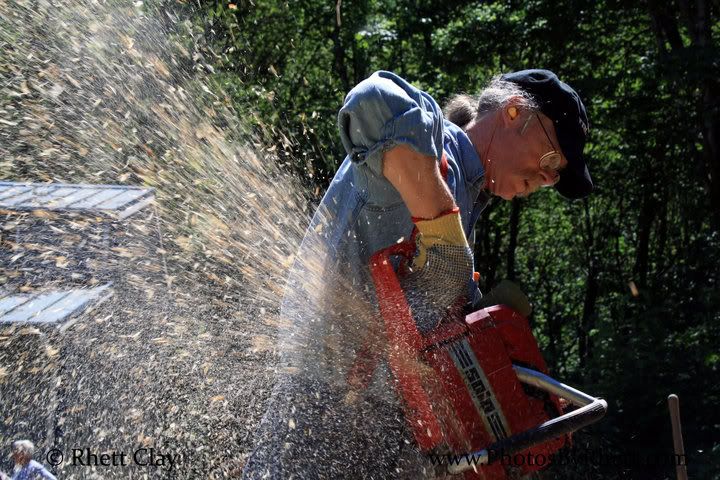

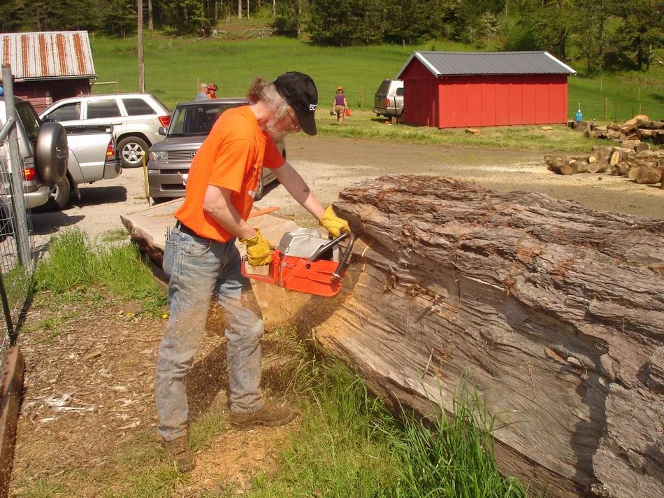

Is it possible to cut without standing behind the saw? Do people really cut while standing to the side of the saw? I understand keeping my head out of the arc line, but I tend to cut by standing behind the saw so I have greater control over the saw. Think I would need a visual demonstration of what you are recommending.
I try to always be off to the side, if that sucker decides to fly, it will go right by. It isn't always possible, it is something to keep in mind. Being hooked by the Bull's horns is unpleasant.
