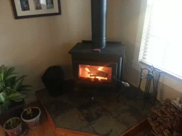

First fire! 42 outside 63 inside this morning so the wife said fire it up!
I was happy to.

Looks like a good start to the morning!
It may be an illusion but that stove looks awful close combustibles.
It's probably the shields making it look like that. I've got side heat shields and rear. It is about 1 inch too close on corners though. They call for 8.5 and its at 7.5. I'm gonna probably add some 45's to get me a few more inches clearance just to be on safe side. I had it up to 600 last year once though and couldn't feel any heat on wall
