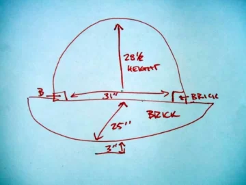

Been looking for a wood stove to fit into this existing brick fireplace in my 1930's home, sq ft is 1400 ft and will be main source of heat. I'd like a glass door. I've searched and searched and am frustrated that the ones I love will not work. I'd hoped to spend about $1000. but that's seeming unlikely:) Installation will be around 1400. (is that reasonable?) Forgive the bad drawing please. The top height of the opening is 28 1/2 " and the depth of the opening is 29" on the bottom and then curves up to 19" at the top. Ideally I'd like it to sit inside the opening so I don't have to choose a rear vent. Thanks so much for any help, I'm losing my mind trying to figure this out.

Your best bet will be a stove with a rear exit, many will fit that height. What is the reason for not wanting to go this route?

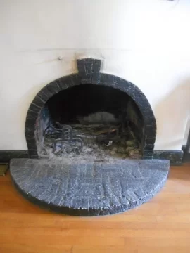

I'm wondering if the Jotul F3CB will fit in there. Take some chalk and mark 23" high on each side of the arch. Then measure the width and report it here. The 602 and some small Morso stoves should fit in there as well. And looks like the Jotul F100 would slip right in. None of these stoves though are good for 24/7 heating. The firebox is too small.

30" across at 23"high. I've lived the last two winters in this house with only space heaters and just basically avoided half the freezing house so anything would be an improvement but I'd love to go ahead and get one that really heats the space.

Based on your measurements it may fit. It will heat the space for the most part but you will be feeding it every 4 hrs in cold weather. Another option might be to put in an insert without the surround. That will give you the steel stove look. Is there a flat floor in the fireplace?

The floor isn't flat.

I misunderstood, it's not bumpy just has a single brick edge on each side. I marked them in the drawing. Inside that is flat and smooth.
OK, I saw that on your drawing. It looks like you could fit a decent sized insert in there. Better than a smaller freestanding stove. Something like this Century would fit. The surround can be left off.

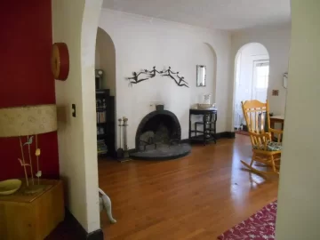

This is the living room and now I'm thinking I need to paint the fireplace wall red before I get the wood stove in. Anyone in Asheville NC area who does installations? The options I have so far seem kind of pricey. Anyone want to paint the wall for me:)
