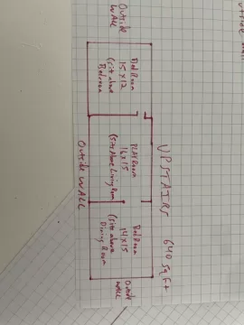

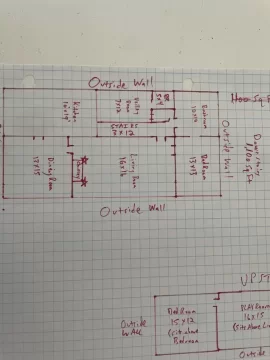

So we're in the process of getting a wood stove installed, but I've quickly realized how little I knew and what the process entails. We have an 1800 sq ft two story house in Central KY with about 700 sq feet that was a log cabin built in the 1800's, and was added on to. Needless to say, that portion of the house is poorly insulated, (which we're trying to address also) and wintertime in the house is no fun. The home has an existing interior masonry chimney (30-35 ft), which we had inspected and we would be installing a hybrid pre-insulated 6" SS liner. The stove would be going into the first floor living room which is in the center of the house, but also one of the original log rooms of the house and poorly insulated. The living room is 250 sq ft, but fairly closed off and not an open floor plan. When we bought the house we put in mini splits, with multiple units located on each end of the house, but quickly realized they weren't sufficient to heat the entire house. The hope would be that the stove would help heat the majority of the downstairs, roughly 1100 sq ft. I had located a Fisher mama bear, but I feel like that may put out too much heat in the room and make it unbearable, in addition to taking up too large of a footprint. I'll more than likely need rear vent stove, given the pre-existing configuration and fireplace dimensions, and have realized those options are much more limited. At this point I feel stuck and was hoping to get some suggestions of feedback from anyone with a similar situation, thanks all! I've posted a photo where the stove would be going and the fireplace opening is 25"Wx31"Hx11"D.

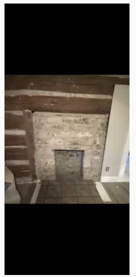

Here is the fireplace, overall dimensions of the masonry portion are 60" W and 63"H

I think several of the Woodstock stoves, either their classic catalytic soapstone models or their newer plate-steel hybrids, would rear-vent into that lintel height. Their soapstone cat stoves have a long track record and are reliable, well-engineered stoves...lotta cast iron in those babies. 😏 Their newer hybrids (cat and secondary burn) have been out for several years now, so there are reports by users as to how those are performing.
Your current hearth may have any needed floor protection already built in, if there's concrete beneath the tile. OTOH, some stoves require no floor r-value protection, just ember protection which can be provided by a piece of sheet metal or layer of tile.
If you want to go non-cat, rear-vent options are limited. I think Jotul has some, as well as a couple other makers whose names escape me at the moment.

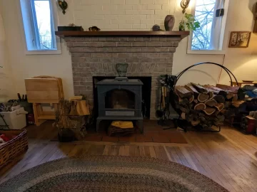

Would an MF Fire Nova work in that spot?Hello from Irvine Ky. I had a Nova 2 installed in my fireplace with dimensional constraints as well. Barnhill Chimney in Lex did mine.
Hope you're staying warm! I looked at the Nova's and love the way they look, but not crazy about the fixed air control. How do you like yours so far?

It is fairly new to me, but I like it. I feel like the wood needs to be solid on the moisture front for it to work the best. The stove runs well in a 400-550 sort of zone on the stovetop temp gauge. Mine is set in a stone heavy spot so it acts as a thermal sink and temp seems very even because of this. It is not my main source of heat, but as cold as it is today it is keeping 1400 square foot warm easily. Glass view with burn pattern is fantastic imho.

Hmmm, the floor plan isn’t the best for wood heating and the room is small. The log cabin part and stonework will buffer heat to some extent with thermal mass. I think my main worry would be chimney height and too much draft with that much interior chimney.

Fitting woodstoves into fireplaces can be hard when attaching the liner. You may need to look at inserts.
But 2 I found that would fit are the Drolet Spark and PE Vista. I'm sure there's more. The biggest issue I found was the height. Many stoves are 30" tall.

I would get a stove that heats air (one with a convective jacket and blower,) then use a small fan like I described, on low, outside the stove room doorway, slowly moving cool air into the stove room and displacing warm air out the top of the doorway. You want that fan on low so it doesn't disrupt the natural convection loop already happening through the doorway. This will keep it comfortable in the stove room at sitting level.

I don't think much will fit in the fireplace which is only 11" deep.

All the Woodstocks are cats or hybrids, and don't have convective jackets and blowers. You'll be able to heat more air faster, then move it around, with a jacketed stove with blower.
Is there a hallway in the center of the house, running parallel to the stairs, or just the doors we see? Are those doors standard width, like 30 or 36", or are they wider?

Instead of a freestanding stove, consider an insert. If necessary, to make it fit the shallow fireplace it could be run without a surround.
I would not be afraid of putting in a 2 to 2.5 cu ft insert. It takes a lot of heat to keep the log cabin side warm. You can burn smaller fires during milder weather.
For a budget insert consider the Drolet Escape 1500i.
For a budget freestanders, look at the True North TN20. It's 2 cu ft and has a nice square firebox. There's also the Drolet Spark II. It's a basic 1.55 cu ft stove, with N/S loading and lists for under $1000. The regular Drolet Escape 1500 might just squeak in - measure twice.

I really like the look and simplicity of the TN20, just curious how much heat you think would be lost up the chimney, where it would have to set back in the fireplace a bit?
There must be a block-off plate at the damper area to minimize heat up the chimney. A blower on the stove will help a lot in this situation.

I had meant to add that installing one may be difficult given the way the chimney was built. Is the block-plate strictly an efficiency/heat gain or is needed in regards to safety too? Thank you for all the information, it’s super helpful
