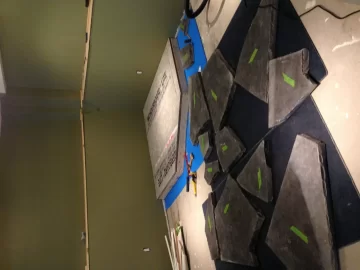

Hey hey, we'll I'm kinda new here but I am in the same boat as you! Although I don't have a stove upstairs I half a half finished basement we were planning on finishing this summer, then I put that on hold so that I could install a stove down there first! Now my basement is essentially finished everywhere but where the stove is going in the rec room there is trim work to do and no flooring! So I just laid my moisture barrier underlay under my pad and started the stove work! After I get the stove completed I will scramble to put flooring down before the winter! If I were you I would finish everything under and behind the stove first that way u don't have to move the darn thing! [Hearth.com] Finishing basement
Hey hey, we'll I'm kinda new here but I am in the same boat as you! Although I don't have a stove upstairs I half a half finished basement we were planning on finishing this summer, then I put that on hold so that I could install a stove down there first! Now my basement is essentially finished everywhere but where the stove is going in the rec room there is trim work to do and no flooring! So I just laid my moisture barrier underlay under my pad and started the stove work! After I get the stove completed I will scramble to put flooring down before the winter! If I were you I would finish everything under and behind the stove first that way u don't have to move the darn thing! View attachment 102471
