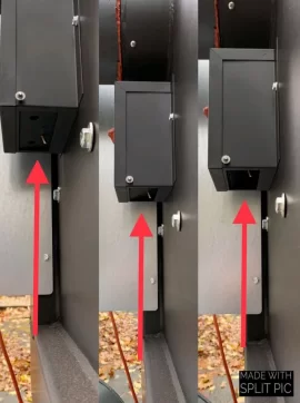

The house thermostat will turn on/off the draft blower however even with the draft blower off, the duct blower will run until the fire box has cooled off.
The secondary air flap is manually controlled.
Not the best photo, but this is how it is controlled.
[Hearth.com] Fire Chief FC1500 install
