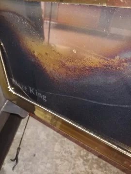

Blaze King- King woodstove glass broke when hubby didn't open the door wide enough. He was adding more wood to the already heated stove when somehow the poker struck the door and it cracked the glass. Luckily the glass remained intact until the next morning. When we removed the door to have a new piece of ceramic glass installed it cracked right off.
My question is this:. Would a fire extinguisher put out a very hot woodstove fire in the event the glass broke right off during the burn? I'm looking at investing in 2 good extinguishers.
Any thoughts on what the best type of extinguisher to use if this ever happens again and we're not so lucky? Thank you.
Ha yup my wife did the same thing years ago when i was away. She ordered a replacement which arrived before i got back. She doesn't use the poker anymore. The old jotul 3 could burn with the door open so no need to do anything with the fire.
But a few years later, when the rear collar broke and the single wall pipe collapsed to the ground, with a fresh fire inside the stove, i did have to take out the burning logs one at a time and throw them onto the front lawn.
