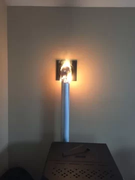

Fire in vent pipe from bees nest

See, I'm glad I ran my brush to the top of my chimney before I fired up the stove this fall at any rate! I must say, it's curious how the fire broke through both walls of the venting though if that is indeed pellet vent.

must have used b-vent (aluminum) piping
I thought the same thing because that's what it looks like, how it melted like that.. Hey, either way it's a great photo for newbies here to feast upon ( or anyone). Make sure you do it the right way guys !

almost looks like burned up rtv, the way its white and chalky looking. But either way that's scary and one hell of a good reason to check your vent before that first fire.

Mine was 'no comment' simply because thats 'B' water heater/gas appliance low temp vent, not Pellet/corn stainless lined vent. It was probably alreadfy perforated prior to the fire, thats meltel aluminumsheet, not galvanized steel. Bees or no bees, was a bad install.
