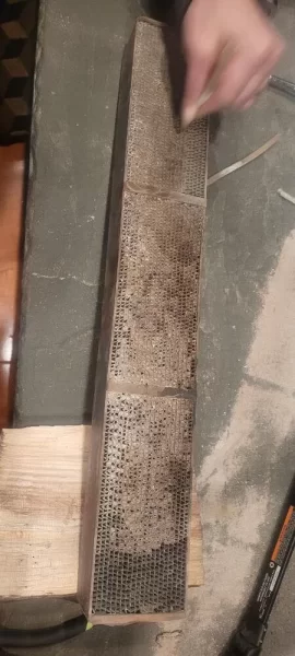

I am thinking this all goes back to likely messing up my piles for a bunch of wood that my kids brought in. It was heavy and burned like iron. This is the first time I have ever had to use anything like a pipe cleaner. Usually the vacuum/brush is all it takes. But, my bigger issue, with the ceramic cats was that they would only last 1-2 years and would break up. I have attached a pic of my issue this time. Vacuuming wasn't doing a damn thing, so I had to step it up. This was done Dec 11th. The cat still looks like I just cleaned it. I had the kids remove all the heavy stuff and bring it out to the pile to sit another year. Here is the pic. What is the diagnosis? Thanks for the help!

The soft brush they allow is over the surface (that you photographed), not inside the channels - to my understanding.
Agreed. There is no way in hell you are getting a brush into those tiny holes. The brush they provide with the stove is to brush the cat surface from fly ash. It is way to large for anything else. The pipe cleaners are very small. Hopefully, I will not ever have to use those again. Thanks.
Reactions: stoveliker
Given the amount of fly ash in your cat, assuming you don't burn cardboard etc, how tall is your chimney? Too tall, too much draft could pull ash to your cat.
If that is the case, a flue damper might be useful.
Big chimney. 30+ ft liner. Draft could be an issue. I am not sure I could use a damper. How would I control it? Everything is behind a nice surround.
Ah, yes. I think your draft is causing the plugging with fly ash.
