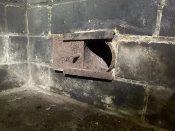

Hello All,
I have recently pulled a propane fireplace insert that was installed in my house prior to purchase. We have a beautiful natural stone open fireplace that is the center point of our open concept living area. My wife and I want to go back to the occasional real wood fire in the fireplace. Clay liner and chimney is in excellent condition. House and chimney built in 1990.
I’ve located what looks like possibly an air supply built into the lower right side of the fireplace. Looks to be about a 2” steel pipe with a sliding steel gate type damper/door combination. A flashlight inside shows that it takes a 90 degree bend toward the back of the fireplace, not sure where it goes from there as I’ve never observed any sort of air supply piping outside of the fireplace or the chimney. I have attached a photo, any help in confirming what this is would be greatly appreciated!

I have no idea, I’d believe someone if they told me it was to help supply outside air. That would drive me insane though. Where does it go!!!? Can you fish a camera in there? Maybe it’s a air supply for a secret bunker!
Now that's intriguing and maybe there is a pot of gold or a buried treasure...Get that camera "ready".. Could it be maybe a damper or something like that--interesting...hope someone knows..clancey
It supply's make up air. It will be almost useless though. A 2” pipe won’t supply enough air for a 12” flue, the additional air will be pulled from the living space. It might terminate in the crawlspace. It could be a Highway for rodents if the end doesn’t have a screen on it.

When you put water on a fire or very hot object it very quickly converts to steam. When it does that it expands 1600 times. When that happens it can cause lots of damage very rapidly. We have seen chimneys blown apart by someone dumping water down a burning chimney
There’s no reason to look into it any further. It’s to supply make up air for the fire. You just need to find out where it terminates. If there no grill on the outside, look in the crawlspace under the house if you’ve got one.
