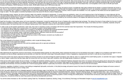

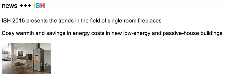

If you have time in March, travel to the enormous ISH Expo in the Messe Frankfurt facility. There will be a plumbing and heating show covering 578,000 sq. meters of space. Inside, one entire hall is dedicated to wood and pellet burning appliances, many of them actually running. Perhaps 100's of wood boilers on display.
[Hearth.com] Fireplace Boiler for Radiant, just a fantasy?
  • [Hearth.com] Fireplace Boiler for Radiant, just a fantasy?

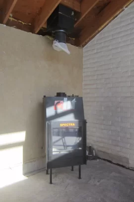

I'm installing one. Just ready to post the wiring and piping diagram. I bought a Polish stove--it does have European certification. I found it on ebay but the seller also has a website. http://www.newhorizoncorp.com/
Unfortunately the fireplace boiler is not on the site. Maybe they were not popular? If you write the owner, Zenon, he may still be able to import them. I had to write the manufacturer in Poland (using Google translate) to get a manual though--they translated it but it is like reading any translation. It is a Cichewicz Spectra Stove. http://www.cwd-group.com/water-stoves-for-wood-spectra-15-30-kw
I think it is a handsome model--well built and came welded to a huge metal plate and crated. I think the freight was included in the price.
The stove can be enclosed to make it look like a fireplace insert too.
