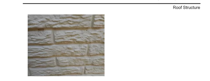

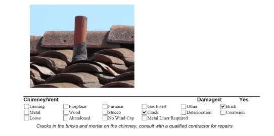

Just got a home inspection on my home as I'm selling it right now. The inspection found a crack on the brick and mortar chimney on the exterior of the home. Crack appears to be a normal brick crack, it's roughly 39" long and is from what I can tell a hairline. The buyers agent got a quote from a chimney/fireplace/masonry place and they're saying it's condemned and would need 30k of work to make safe.
Does this seem right? I've attached a video of the crack. Would this not be something you would just seal up?
Pretty overwhelmed at the moment.
I can't make much out in the video. But that looks like veneer to me. Are you sure that isn't a concrete block chimney with brick veneer on it? Maybe not. But take some still pics with light so we get a better look.
These are the pictures from the home inspection. I won't be able to take better ones until tomorrow when it is light outside.
Mind you, this quote was given to the buyers agent via pictures sent, this was not visually inspected. He said he was giving an estimate of 28-30k to replace the whole thing.

I agree it loos like a veneer. Also a sweep and or mason cannot condemn anything. And that tiny crack it that is all that is there is certainly not to much of a concern in and of itself.

Those look like decorative brick. I bet a dollar yours is a concrete structure faced with brick.
That is a hairline crack. I can't imagine that your fireplace is ruined. I think you are getting bum advice from this inspector.

I dont think that is even a real brick by the way the crack runs thought the mortar joints and brick without changing direction at all.

Turns out I have a Rampart General pre-cast fireplace. Apparently there is no approved repair by the manufacturer and the system should not be used -- this is the opinion of Dale Feb from the F.I.R.E.
I have sent pictures to several different fireplace contractors and have gotten everything from $30k for a new chimney, to $300 to seal the crack. By far the most common answer I get is a complete re-lining for $4-5k.

The crack does not go all the way through. Crack on the outside is 100% superficial, per the inspector that was out here today.
That will not fix anything or bring it up to code. I don't know that fireplace system at all but if those that do say it is damaged and is unsafe to use I would get another opinion or two but a gas log set will fix absolutely nothing. And if it is unsafe to burn wood in it is unsafe to burn gas in.
Like I said before I know nothing about the system so knowing it is a prefab unit and there is no approved fix I would say a complete rebuild is probably the only solution to bring it back up to code. And yes it could easily be $30k Typically a fireplace in our area on a single story will run $15k to $20 but it can be more than that. And 4 to 5 thousand for a fireplace reline is not to out of line It sounds a bit high but I dont know the height or size of the liner required. But I am not sure a liner will fix the issues.
The guy that came out today simply disagrees that these should be condemned or completely replaced from little cracks like these. He said that these prefabs can get rough, but that mine is in otherwise perfect condition and that common sense should come into play at some point. He has never once seen a fire from cracks in these in 40 years he's been working on fireplaces. He said he has had clients who had structural engineers sign off on his work and that he'd be happy to back his work in any way he needed to.
