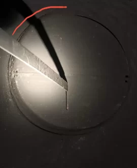

Ive attached a picture. The area I marked in red is the area that catches on the rim of the flue.

Well I'm not too familiar with that kind of damper but I'm sure someone on this forum will be along who knows more about it. Can you wiggle the damper at all or does it feel like it's jammed? If you've never had this issue before it could be that the sweep took it apart to clean and just didn't put it back right.
Reactions: mondomarcus
It wiggles a little bit but not much. I talked to them and they refunded me but admitted that they probably weren't able to look past the damper. Seemed really eager to just give me the refund. Told me they can't do repairs anyways so I should just call someone else.
