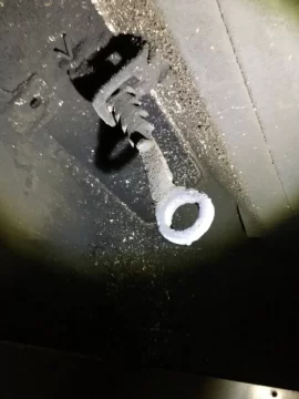

Why does the damper on my fireplace have several notches on the handle?
Shouldnt it be either all the way open or all the way closed? Just curious.
Thanks Bob G
In most cases yes all the way open or all the way closed. But on a well built fireplace with good draft you should be able to close it partially reducing the amount of air being sucked from the house.
Also, depending on the outside temp you may get a stronger draft and not need it open all the way. For example I open mine all the way if it's above 30F but otherwise I use the 1st or 2nd notch, whatever is just enough to keep it from smoking. The fireplace heats better if you're not sucking away all the warm air from the room.
Thanks thats what I was thinking. I was curious if people were able to shut their dampers partially down. My fireplace works well enough but I need to keep the damper all the way open. One notch down and I’m getting a little smoke.
