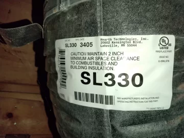

Ok the existing system is a modular fire place hooked up with HHT SL300.in 8" There is between 20-25ft from the ceiling to the cap. My friend wants to get rid of the fireplace and the wooden surround and put in a wood stove in the 50-60k BTU range in its place.
[Hearth.com] Fireplace flue system change over to wood stove
My first thought is to set a thimble at ceiling height and bring down 6" double wall stove pipe to the stove. My thought is the tall stack in 8" may be advantageous to weaken the draw some?

Nothing from the old fireplace will be reused. The wood stove install will need new class A chimney pipe. The SL330 fireplace chimney has a lower temp rating and it's air-cooled IIRC. Do the new system in all 6" stove and chimney piping.
