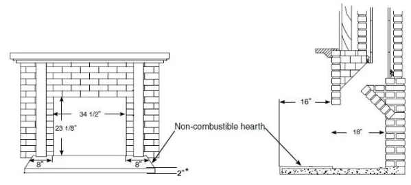

I have been looking at new adding an insert to cut down on the oil bill so I have a few questions. I tried searching but couldn't find the answers I was looking for, if there is an existing thread please point me in that direction. I have a 2700 sq ft colonial in CT with a fireplace on the exterior wall. It has an opening of 32 W 24.5 H and 22 D I can make it 3" wider by cutting some of the brick that is overlapping the firebox. I would like some input on which insert will fit. I looked at an Avalon Olympic and the dealer said he could install it and hook it up no problem with a 6" SS liner. I think it may be a little undersized but didn't know if I would be able to install a larger insert like the PE summit. How would I hook up the liner to the outlet on the stove? What is the maximum dimension for the insert to hook up in the fireplace.
The Avalon dealer said I didn't need to insulate the liner but I think it makes the mast sense to insulate it. I also mentioned a block off plate and he also said it was unnecessary. What is the best way/cheapest way to insulate the chimney and block off plate.
When I got to sweep the liner do I need to pull out the stove or is there another option?
PS I will be installing the insert and liner myself.

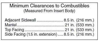

It sounds might have enough room to squeak in the Summit, but that will depend on the taper (vert. and horiz.) of the firebox at the back. Here's the minimum dimensions for the Summit. Download the manual and verify that clearances to combustibles are also ok. Definitely insulate the liner or install one that is preinsulated. The cheap way to block off the damper area is to pack it with mineral (Roxul) or ceramic (Kaowool) insulation. A better way to block it off is with an insulated metal block off plate. Here's more info on that.
