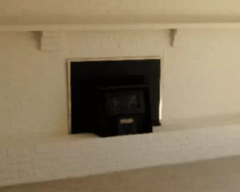

Attached are couple pictures of the current fireplace and insert. The house is a 70's tri-level and the fireplace is on the mail level of the 3200 sqft house.

Welcome. There are a number of good inserts out there. In order to recommend one that will fit, we'll need to know the fireplace interior dimensions. Note that the current installation is not proper also because the hearth needs to extend 16" in front of the glass. This can be at the current stove level or at floor level which probably is more practical.

Not sure if even a flush mount will give you enough hearth clearance. What you have there looks pretty shallow. You can easily solve that by putting a hearth extensions on the floor. Here are some examples: http://www.woodlanddirect.com/Wood-Stove-and-Accessories/Hearth-Extensions/?state=14088 You can also search for "stove boards" to find some less pricey alternatives. Your building inspector/home insurance have to decide whether a removable extension is enough or if it needs to be permanently attached to the hearth/floor.Btw. You may also need to check out the mantel whether it is combustible and you have enough clearance with the insert you want to install.

I measured the depth of the hearth and it is 11 inches so any options and suggestions are greatly appreciated. I have not been able to get the measurements of the opening but the panels measure 42 inches wide and 30 inches tall.

That will not be enough even when you get a flush insert. 16" is minimum in the US and could be more depending on the requirements stated in the manual of the model you choose. You could extend the brick hearth at the same level with the existing one but that will be quite elaborate. Other option is to extend the hearth at the floor level either by adding tiles or buying a hearth extender as I suggested in my previous post. Since your insert is sitting up there I doubt you will need more than ember protection in a floor level hearth but the dealer/manufacturer will be able to advice you on that.
Since it is unknown how much brick the surround covers those measurements won't really help in deciding which insert would fit. You will also need the fireplace depth to shop around. Once you have moved in, see if you can pull the surround off; often you just need to pull it straight up.
