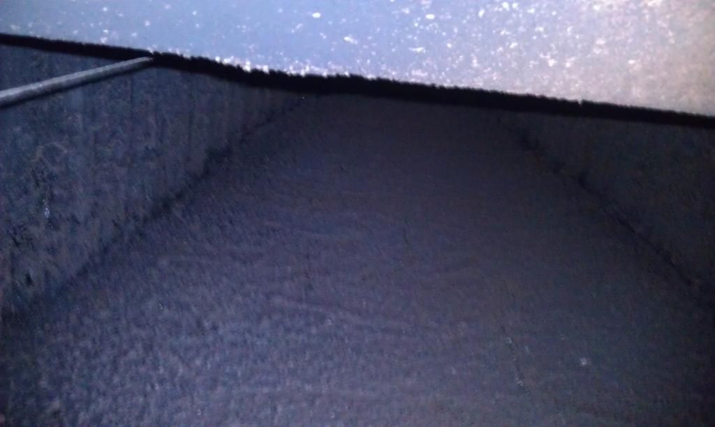

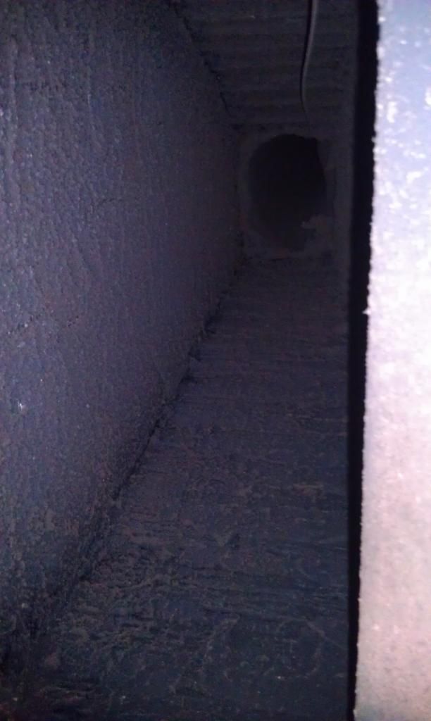

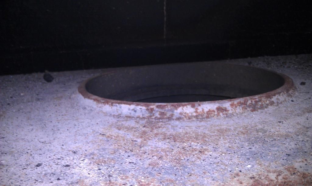

Here are a couple pictures.

what size liner is in the chimney? Was i lined to be used as an open fireplace?
You should be able to get a connector/adapter to add a section of flexible liner and another adapter to fit your stove.
You may run into issues getting the liner past the damper framework.
I installed a wood stove into my fireplace which had an 8 X 12" flue. I got an ovalized flexible liner that fit right past the damper with room to spare.

i cant see how you would connet to that liner if it was done properly as an open fireplace liner
Yes, the liner was installed to be used as an open fireplace, it is already insulated. I just need to figure out how to connect the stove to it.

you would need to measure your liner, try from the top of the chimney. it looks like an 8"x6" imo. so an 8" reduced to a 6" and then squeezed into an oval won't do it for you. you need to remember that your looking for a good seal. you might need to order flex pipe with an 8" input and an 8"x6" output. either way, you need the measurements to get it right. stop running your stove with an open stove pipe right into your chimney. stoves and fireplaces are very different.
The existing one looks allot larger It is at least 8 by 12 but i think it looks larger. And it is going to be way to big for a stove you need to drop a properly sized liner down inside it. And no if that is an 8" outlet on the stove you cant fun a 6" liner on it
