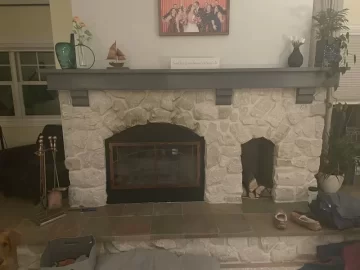

Purchased a new house this summer and it has this Superior BR36 fireplace in it. Was looking to get an insert for it and went to the local fireplace store. The salesman told me they would have to take most of the stone off to get this thing out and an insert wasn't an option. Seems crazy to me?
Got home and am looking at it more and wondering if an can just cut this old one out with a sawsall? There must be some option to replace this without tearing all the stone off.

What you have is a zero clearance fireplace. Unless written in both, your zero clearance and the insert manual, that inserts can be installed you cannot install an insert. What the shop was suggesting was replacing it with a new zero clearance model. The forum has many threads in this topic. My take is 1/3 don’t do anything, 1/3 replace with a new zero clearance and 1/3 remove and rebuild as an alcove for a stove. Last two significant costs.
Ebs-P is right. An insert needs a full masonry fireplace to be inserted in. A zero clearance fireplace does not have that. So you can't put an insert in there, but you can put a new zero clearance unit in there (fitting etc.)
Also note that zero clearance fireplaces have different chimney requirements than inserts and stoves.

I like the stone that is currently on the fireplace. What are the chances that I can just remove enough stone around the insert to get the old one out and re-frame for a new one without removing all the stone from the front and the sides? I'd like to just remove the mantel, remove the stone around the insert, re-frame and install the new insert and then patch the stone back in. This appears to be full stone and not thin veneer.
Looks like the mantel is also to low for all the inserts I am finding. I'll have to move that up about 12" and install some more stone.

Just to be clear. You should not be looking at inserts. You need a new fireplace not an insert

If the stone is solid and you want to keep it, what is the back of the fireplace like? It looks from the exterior windows, it would be the outside of the house. Sometimes installers would actually find it preferable to go in from the back if the desire is to preserve the front. I have no idea if that would be feasible in your situation, but it’s at least worth considering if you haven’t thought of it.
Thats a good point for everyone in this situation. Minimize the inside destruction. In my case, the other side is the master bedroom. I can think of someone who wouldn't be happy disrupting that area. I am going with candles this season. I've got a roof project that is higher priority.
