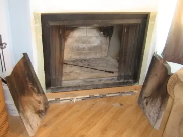

Am looking to install an airtight insert into my factory installed fireplace. This a 20 yr old modular home, the flue and liner are 11" round smooth metal. I assume the liner is insulated but not sure. Got a great deal on insert from my brother, but if I have to install a new 6" insulated liner it will bump my cost up substantially. My question is will I really need a new insert for our safety. Thanks all George

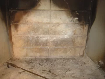

Haven't figured out how to upload photos yet. Also trying to get more info on this house. It is a Marlette modular home approx. 20 yrs old. Fireplace has multiple metal plates in it, I removed the outer plates, but can't figure out the inner ones. It has what looks like a faux fire brick back wall. The problem is the width at the back of the fireplace between the inner plates is 5" narrower than the insert. Insert is a Poti airtight insert. We just moved from Texas back to Central Michigan and with the recent Solar Vortexs, would really want the supplemental heat source seeing as the main heat is a propane furnace.

Hopefully I figured it out

The side heat shields need to stay in. Is there a mfg. name and model on the inside of the front frame of the fireplace?
I couldn't find anything on a Poti insert. Is this an old feller? Got a picture of it?
That fireplace also has zero hearth and would be unsafe to use even without the insert. I would be careful with the assumption that it was installed to code. It may not hurt to have a professional take a look at it. http://www.csia.org/search
How tall is the opening measured from the floor? Probably your safest option would be to put a hearth in front of the fireplace with a rear-vented stove on top. You would still need to drop a liner down the chimney which connects to the stove trough a tee.
