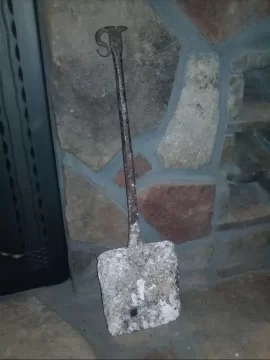

This is my shovel for the fireplace........circa 1740......
It don't smoke at all, and its been around for quite a while......
One of the rams horns broke off of the handle eons ago, I'll be repairing that someday. They don't make tools like they used to.....

Scotty if you have the original or could get me dimentions on the existing rams horn(trace it as best as possible) I could hammer one out for you at the forge. With a little grinding and a mig it would be an easy install and the price would be right - FREE
That is if I ever find time to get back to the forge - been busy lately with work and it is firewood gathering season in my free time.
I am sure you are not in a hurry :) and if it is true wrought I have plenty of that to make it as original as possible
Reactions: ScotO
Thanks, Bob! I'll let you know. I may make it myself on my buddy's forge, as my forge is still in pieces in my shop.....
I have some antique wrought spikes and nails laying around, an old square nail with a little work would do the trick.
