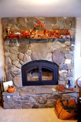

Trail time - do you have a bigger picture of your fireplace? It looks real nice.
Here is a bigger one of mine....

Trail_Time said:
I like your mantle, What kind of wood?
Walnut. We did all the hearth work ourselves. The mantel was a rough piece of walnut that we had cut to size. Then stripped the bark off the "face", hand sanded, the ploy'd.

Very nice it goes perfectly with the rest of your decor. I was going to have a piece of walnut or hickory from our property cut for a mantle, but when I found this old barn beam it was a no brainer. Old, distressed.....exactly what we wanted. I could not have added the character of a hundred or so years of service. And thanks for the compliment.
