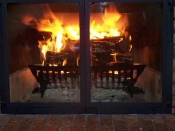

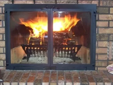

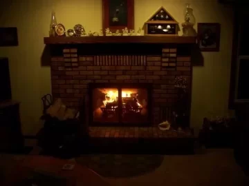

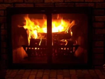

Here are some pictures of my fireplace. Last year I installed air tight doors, outside combustion air, fire bricks and tried a pellet basket but the pellets were hard to get burning. Sometimes they went out other times they burnt up too fast, so I pretty much gave up on that idea.
This year I installed a 2" thick ceramic baffle I found on E-Bay and bought a cheap iron grate with 4" legs which I cut the rear legs off to give it a slant so the logs stay at the rear under the baffle. This baby really throws the heat and I occasionally see some secondary flames. It's in the single digits outside and inside its 87! Once that masonry heats up it stays warm for hours after the fire dies. I think it burns pretty clean, just a little smoke at start up then nothing but heat waves. I was thinking about some kind of air control but it would probably give me dirty burns and dirty glass. Probably just burn 1 big hot load like a masonry heater, seems like that's all I need.
I won't burn it very often since the Fireview can handle most of the heating load for the house from the basement, but it's nice to have a nice big fire once in awhile and it can handle those over sized pieces that can't fit the stove.

This fireplace definitely eats the wood, probably would take more than twice the amount of my stove to heat the house all winter, but it's nice to have a huge flaming heat machine once in awhile. Since I made these improvements the fire lasts longer and the heat generated is fast and furious. I think I may experiment with the air supply to see if I can control it more.
