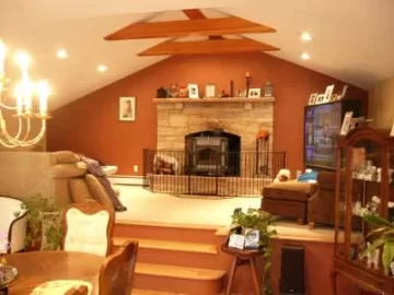

Well here she is. And i love her!
After months and months of researching i settled on the Fireview and i'm very happy that i did.
After 3 burn in fires, I've had it burning for the last two nights just learning how it works. It's amazing how such a small adjustment makes such a big difference in the size of the fire and the temp. And now i know what the Sweet Spot is! It's really cool when the combustor is engaged and the orange cloud appears above the wood.
I have a ranch style house and the stove is in the highest part. The living room is two steps higher then the dining room, kitchen and bedrooms. It's been in the 40's at night and the house is about 75 at the T'stat in the hallway near the bedrooms. I run the A/C to move the air to the bedrooms, but most of the heat stays trapped near the stove at the highest part of the house. I knew this would happen but i was wondering if anybody has a similar layout and what they did. Would a ceiling fan work or an Eco fan?

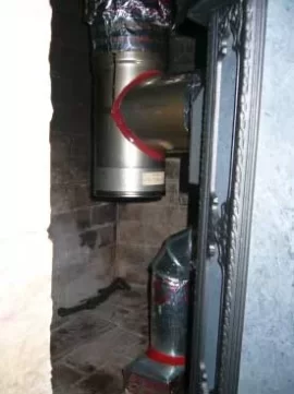

Here's some pics

That's a beautiful sight. Nice looking fireplace too.
I'd try a ceiling fan blowing upward, to try and increase circulation. If it works, it will pull cooler air from the lower areas and displace it with warm air that is stratified at the ceiling.
No tips for you, but that is a lovely stove!

First thing I'd try is a ceiling fan. Second thing I'd try is moving cool air from the remote rooms toward the source of the heat somehow. Running your central system fan may or may not be effective, depending on how your ductwork is configured. Typically the ductwork associated with a central system runs through unconditioned spaces (either attics or crawlspaces), and even though the ducts have some insulation on them, they give up a lot of heat during transit. Not a big problem if that heat's being generated by the unit associated with the air handler, that's what the system's designed to do. In that case, the air starts out a good deal hotter than if you're just removing air from one room hoping to get it to another while still warm. Terrific looking installation! Rick
Looking great! Try moving air with a small fan in various spots pointed towards the stove room.

Very nice room. It looks great.

I agree--gorgeous fireplace and stove. Ceiling fan should help alot, along with using a floor fan(s) to blow colder air towards the living room. Enjoy that beautiful setup. You're going to stay nice and warm this winter.
Looks great. Whats the clearance from the front of the stove? looks like it right on the edge of the hearth.
Since the front window doesn't open, the clearance out front is much smaller than a typical "front door" stove. This is made up for by the large rear and side clearances.
Very nice stove and install. Even looks like outside air ducted in from the old ash chute.
It's real close to the edge of the hearth about an inch. The controls are on the back so i couldn't push it in any further.
