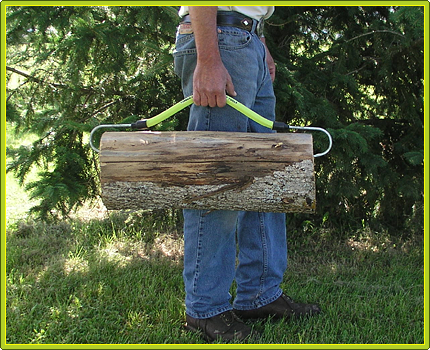

    best tool I came across recently, from Baileys, is a rubber strap twin hook deal to make picking up the log easier. With one in each hand I bend over way less and never have to use two hands on one log and rest it against my belly to get it to the splitter. These are a life saver in my world.

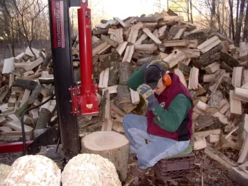

    Its hard work. Period. I'm 42 now and been doing this seriously for about 5 years now, but messing with wood and saws for just over 20 years and I have gotten a little smarter. I take my splitting axe with me when I scrounge so I can bust the big rounds into manageable pieces before I lift them onto the truck. I bought a couple Pickeroons so I can drag logs and roounds around without bending over, or pull them out of the truck from the ground.
    [​IMG]
    I try to split as I unload the truck so that I can use gravity to get them on the chopping block. I also bought and old garden tractor for fairly cheap to haul the wood around instead of the wheel barrow.
    [​IMG]
    Its still hard work, but every little bit helps.

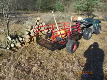

    49 last month,been working in the woods part time since I was 17ish.Plus commercial construction full time,some heavy & dangerous jobs since I was 21.The usual muscle aches & pains from age,over exertion & weather conditions plus once every year or two my back might go out for a couple days.Listen to the body now compared to when I was younger.Still have the strength when I was 25-30,but no where near the endurance now.As I've gotten older I dont try & do everything all in one session.Take frequent breaks,stay hydrated,quit when I'm tired etc.Nothing to prove anymore,the work will still be there when I return in a few days or weeks.
    Different 'helpers' & shortcuts as I gotten older to make work easier & more productive.Various heavy ropes,cables,3 different length log chains,come-a-long,small 12V winch,hi-lift jack if needed,cant hook,peavey,heavy timber tongs to pull with pickup or garden tractor,contractors wheelbarrow,2 wheel handtruck for flatter ground,6 ft johnson bar made from 1 1/2" rebar etc.Even used an old 7ft ash toboggan in deeper snow to haul wood short distances from shed to the house.
    And sometimes a couple Naproxen maybe 1-2 days monthly for those extra heavy days.Generally it depends on how I feel when I wake up whether its gonna be a painful day or not.If its a cold rainy or snowy day,that means more aches.

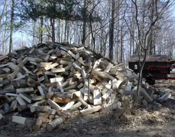

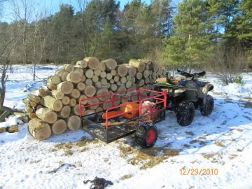

    I've only been burning wood a few years more than your age and I'm probably getting dumber but who knows? I used to do all the splitting by hand but an injury forced me into hydraulics and I wish I'd gone that route many years before! It really is worth it if you get the right splitter and work right. Work smart and that means splitting the wood just like you do by hand, with the log standing upright. This means you need a vertical splitter and if you are like me, I like something to sit on. But it has to be the right height for it to work nicely.
    But to take it from the start, we have our own woodlot and I own only one small chain saw. I wrestled with the big saws when I was a young lad and don't want to do that today so I have a Stihl Farm Boss 290 with a 16" bar. It does all I need done.
    We cut during the winter months which for us means we usually start cutting around Dec 1 and finish by March 1. We stack the wood during the winter and then after snow melt we do all the splitting. Immediately after splitting we stack the wood. We have an atv and a trailer for hauling the wood. Other tools are a cant hook (a must), a hookeroon and log tongs.
    Splitting pile 12-29a.JPG Canthook.jpg Hookeroon.jpg Log tongs.jpg 4-4-09 Almost done.JPG Denny-April 2009h.JPG
    We stack the wood on poles that we cut in the woods (you can see some under the stacks in the last photo. We leave the wood stacked like this through the summer and fall but before the snow piles up we then cover the top of the wood stacks using old galvanized roofing. We do move enough wood into the barn for the winter needs but leave the rest outside. We try to always have a minimum of 3 year wood supply all cut, split and stacked. We do not have nor need a moisture meter as we make certain we have enough time for the wood to dry properly.
    The biggest helpers we have are the chain saw, cant hook and hydraulic splitter. The splitter is a 20 ton that is over 20 years old and it works nicely. The log tongs are a recent purchase and I wish I'd had these sooner. For example, many times we have to work with snow on the logs or wet wood. Now we don't have to handle the wood and have wet gloves and this also means we don't have to bend the back so much to pick up the wood. Also, when cutting trees we sometimes have to cut into short sections to drag out to the trailer and I don't like dragging the whole tree because of dirt getting into the bark and dulling the saw. Now I cut into 4' sections and those tongs work nicely for dragging those short sections out.
