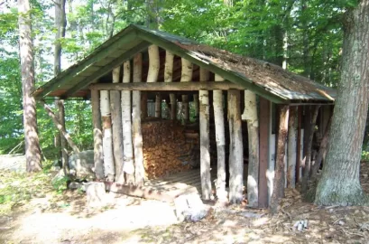

In the next couple of weeks I want to erect a simple structure for storing my firewood in. I am thinking about sinking poles into the ground and framing a sloped roof over it. Being the frugal type I would like to spend as little as possible, I am wondering if ash would be suitable for the upright poles or would it rot quicker than say cedar. I have ash available on my property but if it wouldn't last I could scrounge some cedar at work. I am thinking of using aspenite (chipboard) for the roof cover with rolled roofing or shingles whichever I can get cheapest. I will be stacking the wood on pallets which I already have. Any input would be appreciated
Here's one I saw at a camp on a lake in NH last week. This has a pallet floor and does have some 4x4s in the corners but the poles make good walls and leave plenty of room for air. I understand they tack plastic around it during the winter.
  • [Hearth.com] Firewood storage ideas.
If you have access to cedar it will certainly outlast the ash by a good bit. If not, one way of helping to slow down rot on the portion you'll bury is to soak that portion in preservative allowing the endgrain to drink it's fill, let it dry then tar it. If the fill you're burying it in doesn't drain well replace it with sand and gravel to help keep as much moisture away from the post as possible. It'll last a good while underground.
Get some used drain oil from a diesel, put in pail and soak ends in it. Works great, farmers have been doing this for a long time.
