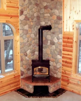

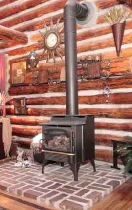

A freestanding stove can be installed in a corner with a nice hearth. The hearth can be built larger to accommodate a wood rack, kindling box, boot drying rack, etc. The hearth can have a back wall treatment or, as long as the clearances are honored, no back treatement, just the exposed logs.

Both of the photos you showed me have a long stovepipe before the 90 going out to a chimney. I was under the impression that the only place a 90 should be used was at the connection to the stove - or since this is a vertical vent stove, does this fit under "stove connection"? Our old Gibraltar has a rear exit, which means that you have to open the ash pan door and induce a good draft before opening the wood box door if you don't want to chew smoke. It lingers in the box before finding its way over the smoke shelf and back through the horizontal to vertical transition. The glass hasn't been clean since I replaced it 20 years ago.

These are just random illustrations of stoves in log cabins. It's always better to run the flue system straight-up through the home interior and out the roof.
