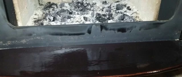

So far ive only had 5 splits max and maybe i havnt turned it down quick enough but once its closed man the thing gets hot! Im almost scared to load it full, feel like its gonna run too hot. But even with my ir pointing at the exhaust through the vent ive only been up to 600 maybe. You guys have more secondaries on back air tube? My glass on both sides has been a little dirty but middle is clean...
This is turning into a little users group.
I don't recall if there are more flame on the back tube, I'll check at some point, though the weather has been beautiful here.
You have the fan running, right? If you're thinking that things are getting too hot, you can always bump up the fan speed to high.
Yes fans on auto low, i only shut it when opening door. I dont think i have any door leaks either, i used 4 washers, might try dropping one on the latch
If it passes the dollar bill test, I wouldn't bother. Do the [big] flames go down when you push the rod in? If so, I think it's behaving as it should.
Yeah they go down but not like i could snuff it out if i wanted too unless its a small fire and just getting going. Theres no air intake mods on these like ive read on others right?
Think i had a door gasket leak!
Ripped into it a little to see how it breathes, with the latch closed there is a little cutout that doesnt get covered. There is also a small hole on the right side in the same spot as if the air control rod was on that side. I stuck a bolt in that, fixing the door leak though id imagine should give me the most improvement. [Hearth.com] First Break-In Fire Hampton HI300...have some questions?
