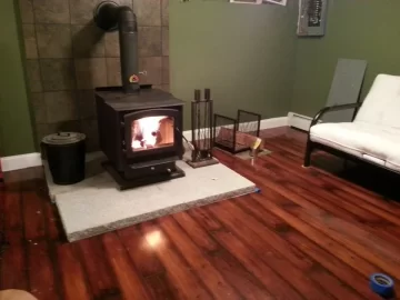

Well it got a little cold yesterday so decided to have my first fire in the new NC-30. The inside is a cavern! Just had a small break in fire. Hearth is almost done! Just need to trim and put the granite mantle on the top and it'll be complete! I really like the 30, think I'll be loving it in a few weeks when we need it!The hearth is granite on concrete as this is a first floor install. All clearances have been exceeded and the back of the hearth has metal studs on concrete with a 2" air space. I will have to space the granite mantle on the top to allow airflow but it should look good.

Nice. Keep working on those break-in fires. That stove is gonna gas you a couple of more times. Do it while you can still prop the windows and doors open.

Yea I had the windows open yesterday. Looks like it will be cool enough to justify having another one tomorrow night and maybe Wednesday. I read on here three break in fires should cure the paint and it will be good to go.
That is a good plan. Keep in mind that it will even off gas a little more with every "new" peak in temp. Just warning you up front.
Enjoy that beast.
Is that single wall pipe just stuffed directly into the flue collar?
It is single wall pipe running to a 6" to 8" adapter with a trim ring around it. with an 8" insulated wall thimble behind the adapter.

Installed per instructions. Single walled 24ga male end in flu collar.
So it fit well or was it sloppy in the collar? Single wall manufacturers often offer an appliance adapter and the instructions you quoted do not make it clear whether the adapter is required. That is why I inquired about your experience.
It fits tight into the collar. Was a pita getting it in there.
